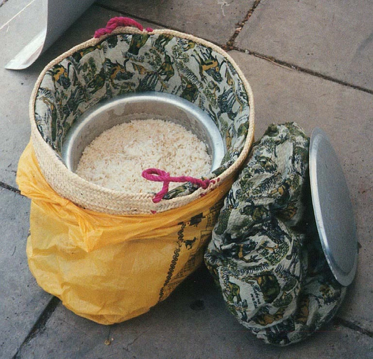

    The haybox itself is any kind of insulated container that can withstand cooking temperatures and fits relatively snugly around the pot. Hayboxes have been made using hay, straw, wool, feathers, cotton, rice hulls, cardboard, aluminum foil, newspaper, fiberglass, fur, rigid foam, and/or other suitable materials as insulation. The insulation is placed between the rigid walls of a box, within a double bag of material, or lining a hole in the ground. “Instant hayboxes” have been created by wrapping a sleeping bag, blankets, and/or pillows around a pot. The most effective insulating materials create many separate pockets of air, which slow down the movement of heat. 2 to 4 inches of thickness (depending on the material) are necessary for good insulation. Some materials, such as aluminum foil or mylar, actually reflect heat back toward the pot. Important characteristics of any insulating material incorporated into a haybox include:
    • It must withstand cooking temperatures (up to 212 degrees F or 100 degrees C) without melting.
    • It does not release toxic fumes (any kind of foam insulation needs to be covered with aluminum foil or mylar) or dangerous fibers (fiberglass also needs to be covered).
    • It can be fashioned to be as snug-fitting as possible around the pot. A little pot in a big box will not cook as effectively; it’s better to wrap pillows, towels, or blankets around it to fill up the space.
    • It can be made to form a relatively tight seal, so that heat does not escape from the cooking cavity. Since hot air rises, a container designed to open at the base rather than the top will retain more heat.
    • It is dry, and can be kept dry, since wet materials don’t insulate as well. An inner layer of aluminum foil or mylar helps keep cooking moisture from entering the walls of the box. Mylar, which can be salvaged from used food storage containers, balloons, etc., tends to be a more durable inner layer than aluminum foil.
    • Cooking containers, too, should have tight-fitting lids, to prevent the escape of heat and moisture.

    • November 2007: At the 2006 International Solar Cookers Conference in Spain, Wietske Jongbloed of the KoZon Foundation learned a useful trick fromDavid and Ruth Whitfield: a heat-retention cookercan be made from empty rice bags. The Whitfields advised that two large rice bags, with insulation such as wool or cotton in between, make a sack that will keep a pot of food at cooking temperatures long after it is removed from a heat source. KoZon introduced the idea in Tahoua, Niger, where cooking pots are typically very large — 12 to 16 liters. For these pots, four rice bags are needed to surround the pot, and a fifth bag stuffed with insulation covers the top. Of this five-bag system, Jongbloed says, “It is named ‘Idadafoua’ and works marvelously.” Jongbloed writes that women in the Sahel cook meals for families of 10 to 12 or more people. The KoZon project in Tahoua teaches the use of three cooking devices — fuel-efficient wood stoves, heat-retention cookers, and solarCooKits. CooKits are used on sunny days for meat or fish sauces, eggs, sweet potatoes, and groundnuts, and for cakes that are sold by the slice to earn money.
