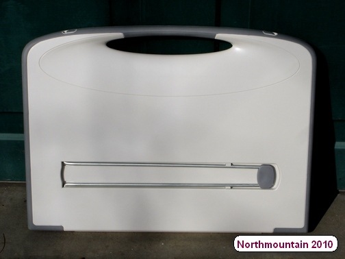

Recharge time for the hub is about 12-hours of direct sunlight or slightly less when plugged into a wall socket. The form factor is excellently designed and includes rubber edging on both units.

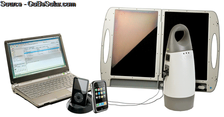

As you can see in this photo, the system can power a laptop and charge small electronics at the same time, although the user must be careful to manage loading. The power hub contains a six-cell, 14.5 amp hour AGM battery.

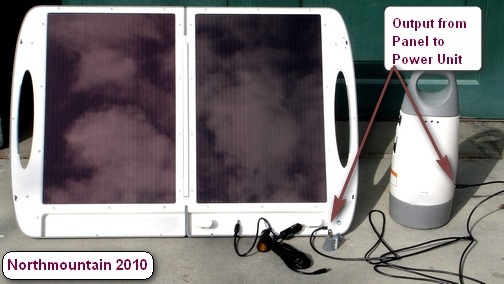

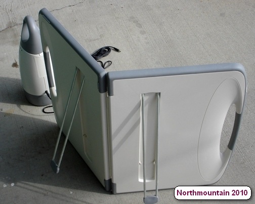

Setup only takes a second. Slide the two latches on the solar panel, extend the support legs on the back of each panel and plug the power supply cord into the power hub. One minute – maybe two max.
Adjust the angle of the support legs so the surface of the panel is approximately 90 degrees from the plane of the orbit of the sun. If it is a windy day, you may want to add an additional support because the panels will act as sail even though the panel is wrapped in a non-skid rubber edge.

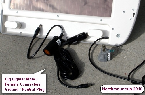

Accessories included in the power hub package include 12 volt male and female cigarette lighter connectors, a 120 volt / 12 volt transformer brick for home charging and a 3 pin to 2 pin adapter plug.

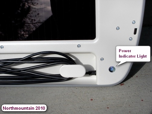

When the solar panels are opened to light, a flashing blue indicator light in the bottom right corner of the panel flashes. When I opened the panels in our kitchen under fluorescent lighting, I was surprised to measure a 12-volt output. I haven’t measured the output in direct sunlight but assume it will match the 12 to 13-volt output noted on the GoBe fact chart.

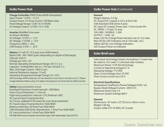

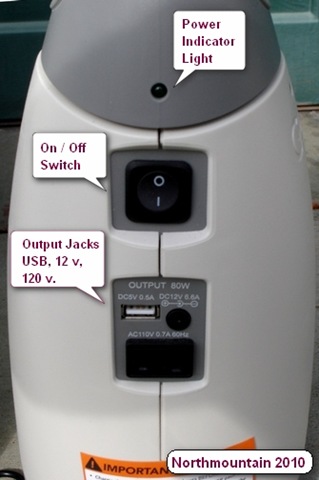

The power hub offers three outlets. 120v -- Because it has a built in 80-watt inverter, one of the outlets will support normal 120v plugs, but the losses associated with the voltage conversion will reduce the length of the charge duration. A 12-volt outlet accepts either of the cigarette lighter adapters and lastly, a USB power outlet rated at .5A. The configuration is well designed.
The use of the 12-volt outlets will extend the life of the charge because the voltage transformation losses are absent.

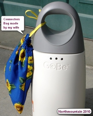

My wife quickly sewed a small draw string bag to hold the power adapters which we keep attached to the power hub.

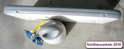

The support legs for the panels snap into holding slots on the back of each panel for storage.
The panel is about 1” thick and secured by two latches and a piano hinge on the back.

    I purchased one of these from Emergency Essentials last month. I also was surprised as to how little light it takes for the panels to start generating power. The drawstring bag idea is great. I have been wondering how I'd keep the cables/adapters with the unit. Thank-you for the solution.
